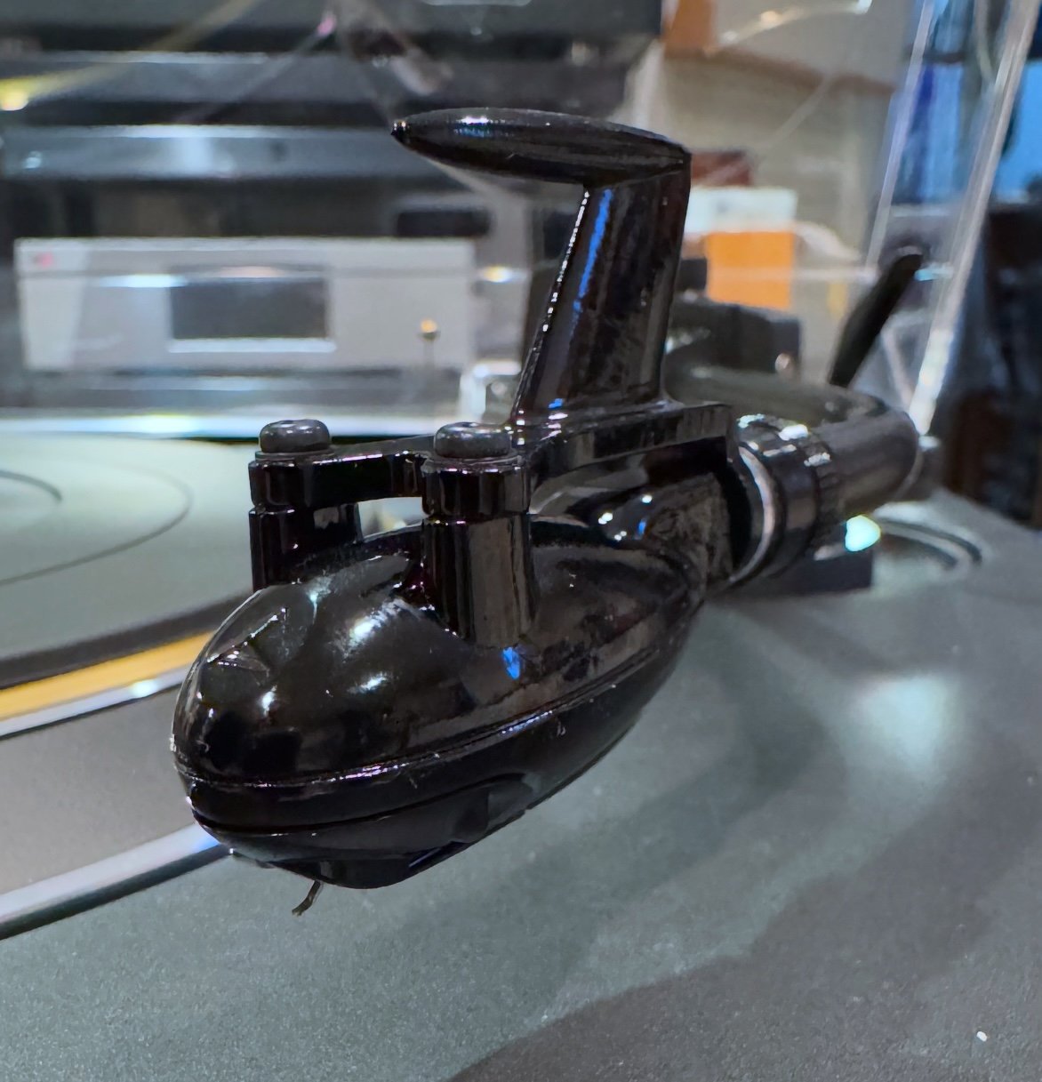

a JICO-nál,vlkinek jó a humorérzéke :D ...tengeralatjáró :smile29: ..JICO Clipper
"It features a conical nude stylus mounted to a tapered “S” shaped aluminum cantilever like what Shure used to manufacture for its M-44 cartridge (the “S” shape, not the taper which new) that JICO says “excelled in beautifully highlighting the clarity and reproduction of the mid to high frequency ranges”. What I heard. This combination produced the warm “classic” sound vintage turntable fans love, and that suits vintage jazz albums but with the blackest backgrounds and perhaps a more linear overall sonic picture.
For instance, Scott LaFaro’s bass was warm, and reaching to the depths but with generous sustain and full control. Evan’s piano was more glorious wood than strings and Paul Motian’s cymbals were more “meaty” than sizzly (thought still sufficiently brassy) and his drums a whole lotta skin. The images were solid and stable.
It’s said we have very short to non-existent sonic memories but this cartridge brought me back at least fifty years to listening to a Shure M3D, though on dynamic steroids. Maybe you don’t believe me. That’s okay. I could stay with this cartridge for all my vintage jazz records. JICO says “We’re thrilled to offer a new way to enjoy your old records, providing a fresh take on a classic listening experience.”
youtu.be/1LIPEcqY2Ys
