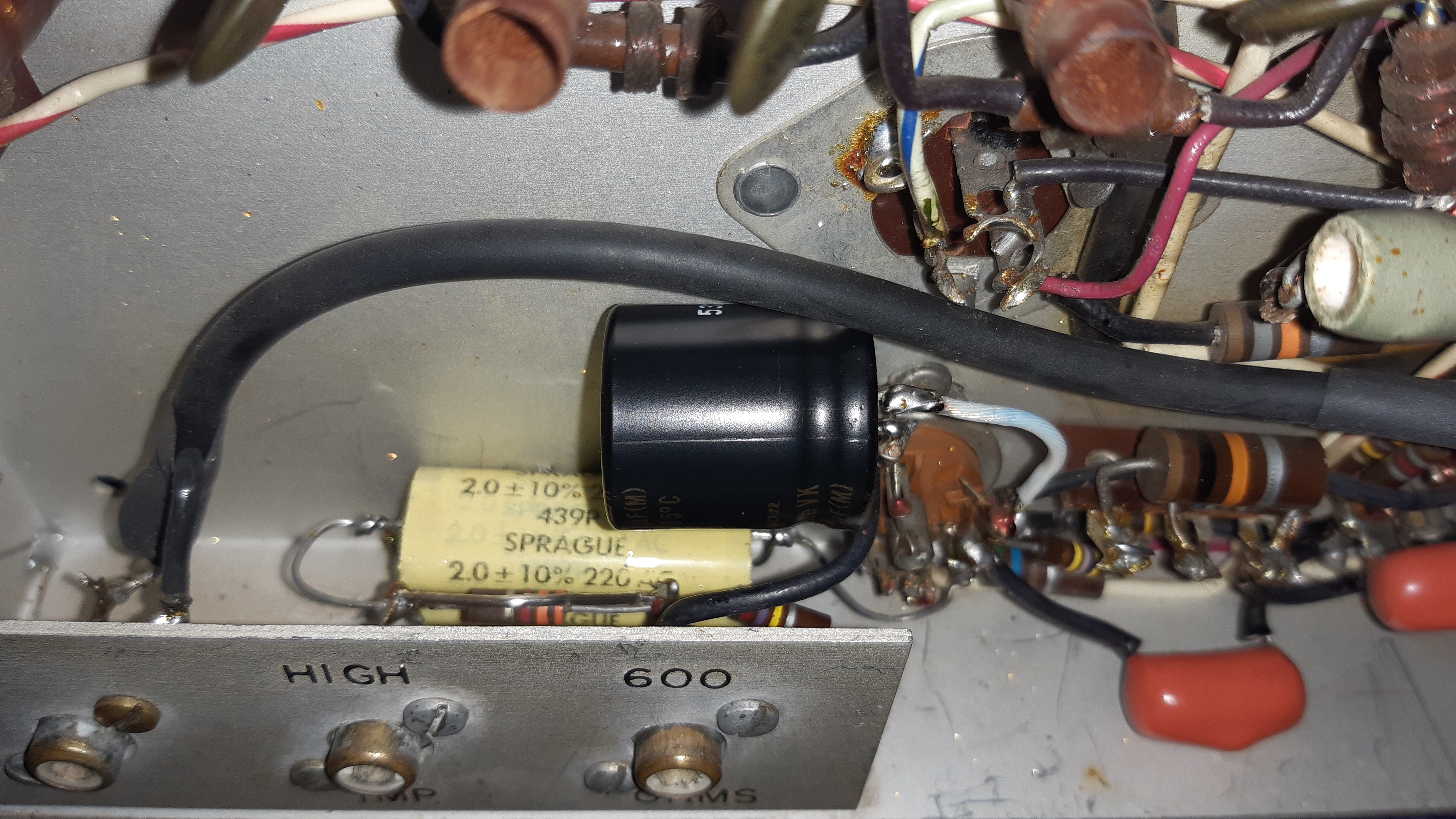

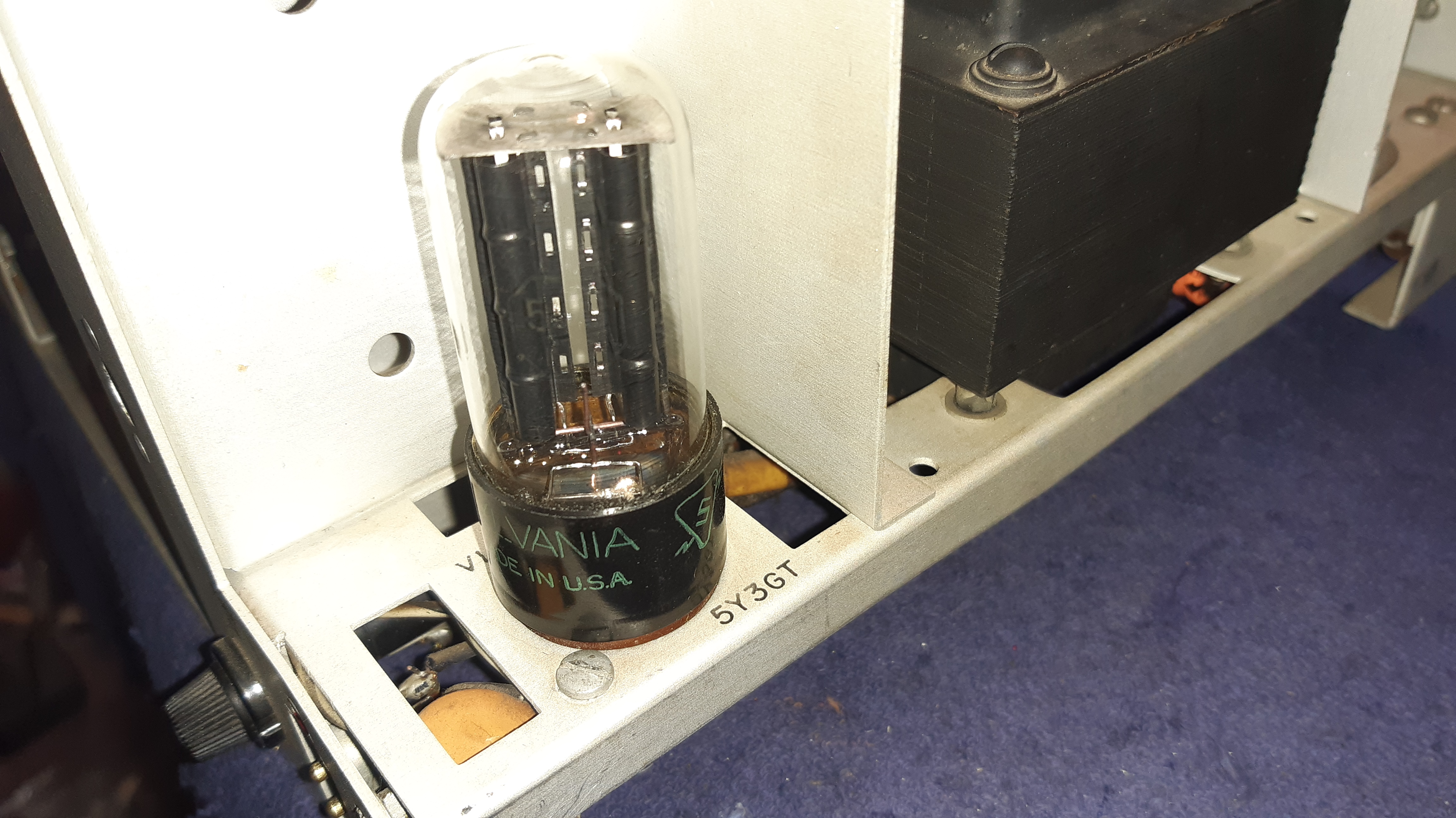

A REL Precedent tuner kapott egy minimál tuningot :D
- Sylvania 5Y3GT
- Sylvania 6201 Gold Brand Black Plate
- RCA 5814A Black Plate 3 mica
- Black Gate VK 22uf/350v
TJ.
